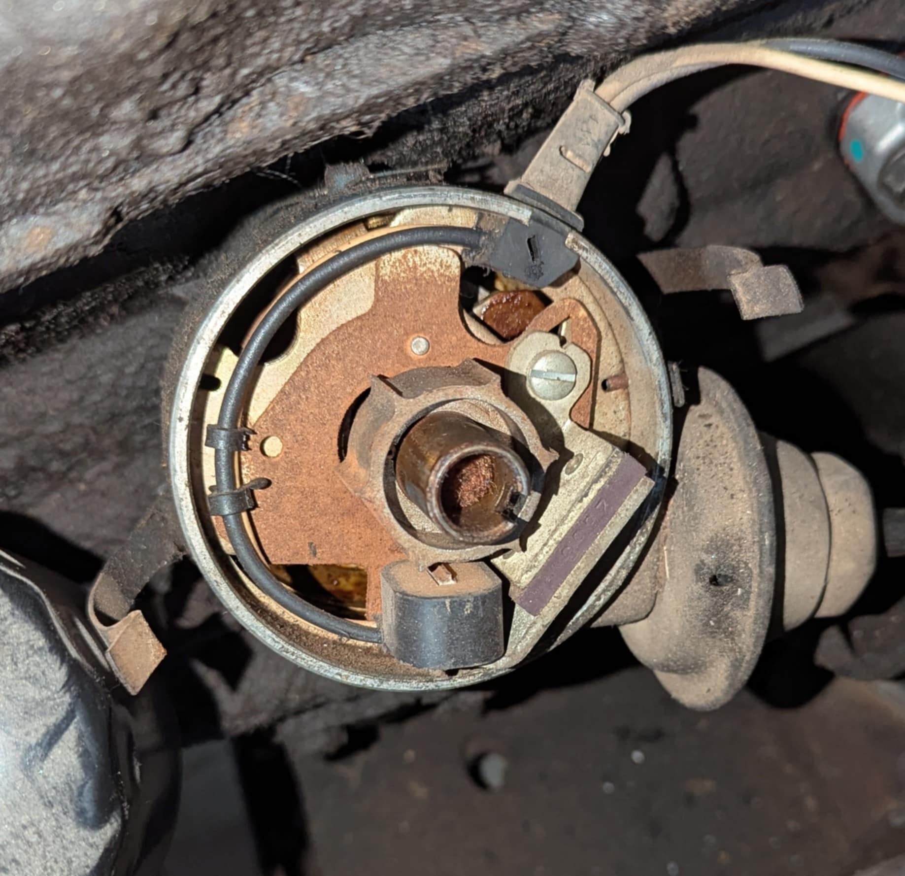

Inherited a B100 with the 225 that has been sitting since 2009.
Carb and fuel pump were gummed up and toasted so they were swapped.
Started under it's own power for the first time in 15 years... Then stalled.
It will run for about 30-45 seconds if started cold and then stall. Won't start again until cold.
So far I have done the following:
New carburetor
New fuel pump
New plugs
New plugs wires
New ignition coil
New distributor cap and rotor
Siphoned the gas and replaced with new
New fuel filter
The issue persists. The pickup coil looked ugly under the distributor cap so the distributor is next on my list. (More economical to replace the whole than just the pickup coil.)
Am I going in the right direction or have I missed something more obvious?
File comment: Pickup coil under the distributor cap.

There's nothing evidently the matter with the distributor; that surface rust won't hurt anything. Pull it and lube the slide pads that enable the uppper plate to move versus the lower one, and lube the advance weights, and put the dist back in.
Siphoning out the tank wasn't enough; you're going to have to drain it, drop it, clean the sludge and trash out of it, pull the sender/pickup, and install a new screen on the end of the fuel pickup pipe (and a new gasket when you go to put the sender back in).
Engine starts-->sludge and crap gets sucked against screen, blocking it-->engine stops and stays stopped til trash floats away from screen (by which time engine has cooled).
