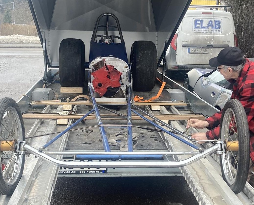

I include a not-so-good photo of his dragster. Well, you can´t see much, but you can see a strange mockup leaning engine block. 8) Photo was taken fresh out from the chassis shop.

That rail is nice.
