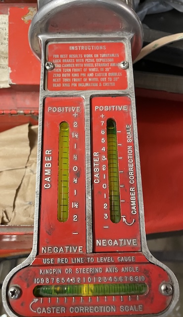

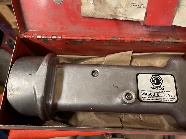

I am wrapping up the steering linkage and full front suspension rebuild on my 1976 Dodge D100, so now it is time to align the front end.
I have sourced turntables for the front wheels as well as an old Matco WA600 front end alignment tool.
To use the tool It looks like I:
(1) turn the wheels straight forward,
(2) set the toe-in,
(3) stick the Matco tool onto the end of a spindle,
(4) turn that spindle 20 degrees inboard,
(5) zero out the camber and caster gauges,
(6) then turn the wheel 20 degrees outboard, and
(7) read the camber and caster settings.
(8) Then adjust as needed and repeat until I get to the target settings.
Camber is adjusted by turning both UCA cam bolts the same amount in or out. Caster is adjusted by turn one UCA cam bolt at a time to achieve the desired reading.
Yes?
My question is does anyone have any experience doing alignments with this tool and do you have any tips to offer me when I try doing my first front end alignment? Am I understanding the adjustment procedure correctly?
Thanks in advance.

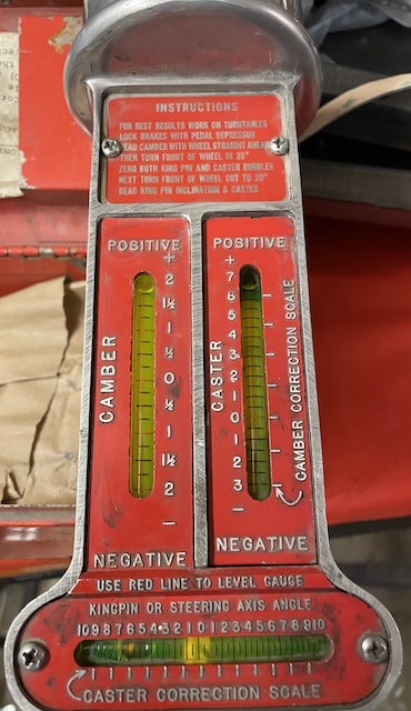

Can anyone give me some clear instructions on how to properly use this MATCO alignment tool? The tool only has the instructions printed on it and I have been unable to find any resource online giving the instructions for this tool.
Currently I have removed the hub dust caps, cotter pin, and spindle nut retainer from each front wheel to allow the alignment tool to sit flush to the snout of the spindle.
This is my current understanding of how to use the tool.
(1) I first point the tires straight ahead.
(2) I attach the alignment tool to the hub using the built-in magnets and the spring loaded guide.
(3) I measure the camber. I adjust both UCA cams to achieve about -0.5 degrees camber.
(4) After achieving the desired camber, I turn the tires 20 degrees inboard
(5) Using the adjusting knob on the bottom of the tool, I set the caster gauge to zero
(6) I then set the "kingpin or steering axis angle" scale to zero by rotating the body of the tool on the hub
(7) I next turn the wheels 20 degrees outboard and check the caster setting.
(8 ) I then adjust the caster to the desired setting using the UCA cam bolts.
(9) I then return the wheels to straight ahead and repeat the process, verifying camber and caster until satisfied.
QUESTIONS:
(0) Do I have a full and coirrect understanding of how to properly use this tool?
(1) What is the "CAMBER CORRECTION SCALE" and how is it used?
(2) What is the "CASTER CORRECTION SCALE" and how is it used?
Thanks in advance to any skilled experts willing to share their knowledge with me.
