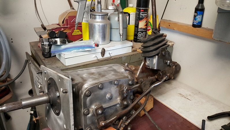

A few more pics, and my A 833 Overdrive from a 1977 Dodge Truck
George sells an adapter to install the 833 O/D with the flathead six. There aren't many 1955 Dodge/Fargo trucks left.
Oh im aware of the A833 plate
Tim Kingsbury and I are very well acquainted.
A lot of the A833 adapter plates have been sold.
I dont personally know whos already done the swap.
I just tentatively bought 2 IND 265s these might end up at Georges.
With 3.23 gears i dont really need an overdrive.
If i go the A833 route would switch to 3.73 gears or close.
