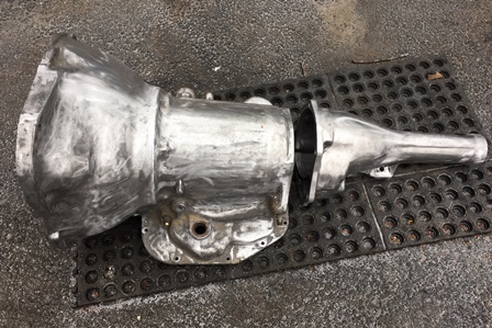

PostPosted: Sun Apr 15, 2018 3:27 pm
Posts: 1482
Transmission case is finished. Trans is now ready for reassembly. I hope to have this thing buttoned up by the weekend.

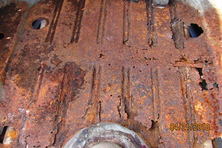

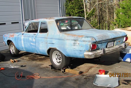

OK, moved the car over to the shop. Vacuumed the inside and trunk. Found some bad news in the trunk. Water leaked in and ruined what was left of the floor. Looks like I am giving AMD a call. The good news is that the interior floor, although also rusty, is solid enough for now. Just carpet and bolt the seats in.
PostPosted: Sun Apr 22, 2018 5:41 am
Posts: 17690
Cut the floor out and weld in some braces for a fuel cell and rivet in a flat alum floor. You can run it like it is for M-D in a month. Just don't pop the trunk in tech...
PostPosted: Sun Apr 22, 2018 6:13 am
Posts: 1482
I ordered the new AMD trunk floor (dang thing costs as much as the interior floor-oof!). It really shouldn't be too difficult to install. I was worried about tech, especially with the battery back there. So rather than chance it, I am replacing it. I need to find some sheet aluminum to place where the rear seat used to be. I am really hoping to get enough done to race it at Mason-Dixon in May. It won't be pretty and might have some duct tape here and there holding it together, but the plan is still M-D in May.
