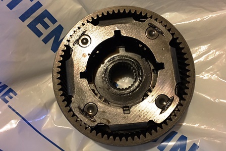

Minor setback with the transmission. One of the gears in the rear planetary apparently has been binding. You can tell which one in the picture, as that corner has turned blue from the heat. I did manage to get it freed up, but it now has a lot of play in it. It would probably work, but it is a lot noisier than the other three. Just to be safe, I ordered a replacement planetary set. I have enough other things to work on until the new gears arrive.

Posts: 17572
Yes, definitely replace... Keep turnin' those wrenches!
