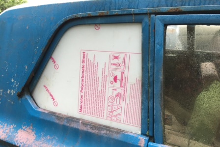

Well, it was raining too much to try to work on the trunk floor. I did manage to cut the poly-carbonate (Lexan) rear windows. I cut both at the same time but have only the one mounted. I still have to remove the other. The factory assembly weighs in at 11.4lbs. The Lexan comes in at 2.55lbs, giving a weight saving of 8.85lbs per side. That was an easy 17.7lb saving. The only thing is, I thought the Lexan would be easier to see out of.

PostPosted: Sat May 19, 2018 6:17 pm
………….. The only thing is, I thought the Lexan would be easier to see out of.
-Matt
You have it in backwards, put it on the other side...……….
PostPosted: Sat May 19, 2018 6:36 pm
Posts: 1482
-Matt
Dang, you mean I have the left window in the right side? The devil is in the details.
-Matt
