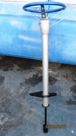

I have everything I need except nice weather to put the engine in. I feel that is about to change. In the meantime, I have been doing 'busy work'. I combined some aluminum, various parts from 64 to 76 Mopar, and some new replacement parts to overhaul my 65 Belvedere column. The original one weighed in at 26.5 lbs. My rebuilt one comes in at 10.6 lbs. That's a nice chunk of weight to shave off (almost 16 pounds) and it looks like a factory original floor shift column. I even have a newer, collapsible shaft in it so it's safer than the OE one.
