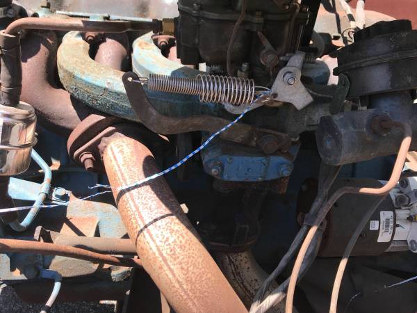

Anyway, I'm looking at a few options .. I've found a low mileage slant in a 72 dart and one in a 79 dodge truck. I keep coming back to the truck engine because it has Dutra manifolds and by the pics, it may be a Super 6 manifold. Can't quite tell by the pic he sent but I'll post a pic. I figure I can sell the intake and make some of my money back and the Dutras... I may have to keep :D
I know there were a few changes in the 70s and is there anything that would change my mind about using either of those engines in my '64?

Crank register change is the biggest thing. It changed in 67 (?) and means a swap to newer transmission, or a special torque converter, which I have found hard to source. If you have a standard transmission, means a flywheel swap...otherwise, I had no major issues changing to a later motor in my 65.

If you have the 9 1/4" or 10" clutch you can use any 1968-1987 122 tooth flywheel, or you can take your flywheel to your machinist and have him open the
register hole to fit the larger crank register...these had the high mount starter...
Similarly you can have the same thing done for the 11" clutch flywheel (low mount starter) in getting the flywheel honed out...this would be preferred
as there is a variation in tooth count between the 70's 11" clutch flywheel and the early 60's flywheel, as well as an offset in the flywheel hub that makes
up for the difference in bellhousing styles between the two generations...
If the price was right I would take the late one with the super six and dutra duals, it would make a nice upgrade.
