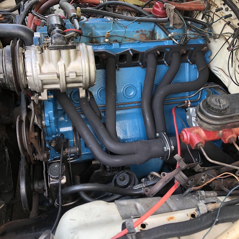

Here’s a picture

 Post subject: Re: Clifford Shorties
PostPosted: Thu Jun 14, 2018 5:10 am
Posts: 5623
Location: Downeast Maine
Nice purdy engine.
Probably you have a vacuum leak at intake to head. 5 lb/ft probably not enough to seal. I just install the same get-up and torqued to 8 lb/ft. with the intention of, if needed, going to 10lb/ft. I replaced all studs, and used brass nuts with a dab of copper anti-seize on them.
Torque spec assumes clean drag free turning of nuts. I you used old studs and nuts, the actual clamping force exerted could very from stud to stud. In other words a 5 lb/ft reading on a freely spinning nut would have more clamping force than a stiffly turning nut with the reading.
Try 8lb/ft and observe compression of gasket. Tip #2 on Remflex package states; "gasket crush should be 50%."
What year is your car. I see a Saginaw power steering pump, and a very different bracket holding it in engine photo. Reason I ask is, I'm suffering with a TWR pump and goofy wracked bracket that required several hours of farting around shimming and fitting it so its pulley aligned with damper. If this red neck garage get-up don't hunt, than I just as soon convert to the much less expensive and simpler Saginaw arrangement.

Many thanks. I will twist the manifold nuts up to 8 ft-lbs and see what happens.
This is on a 1980 Plymouth Volare station wagon. I think the pump bracket is similar to the brackets on other Volares. I think it's probably the stock setup as everything else on the car has been original so far.

You likely have the intake or headers hanging up on something and preventing the flat sealing of the intake to the head. Also, the remflex may not cover the exh flange on the headers completely and allow an exh leak, but that would be a popping/farting sound, not hissing. You need to always put the int and exh on with no gasket and check for flat/parallel alignment before assembly. Remflex cannot fix misalignment. We just found a big hole on Brian Mimken's where the remflex meets the Clifford shorties and does not cover all of the flange opening.

You might consider moving the tranny cooling lines, they are very close to the headers it appears from the picture. Perhaps I'm not seeing it for what it is. If they are 1/2" or more away should be fine. I ran mine on the other side of the engine, along the frame, but I fabricated flexible lines.

@67 Dart: Thanks for the idea re: tranny cooling lines. I think there's at least 1/2" there but I will take a look to confirm.
