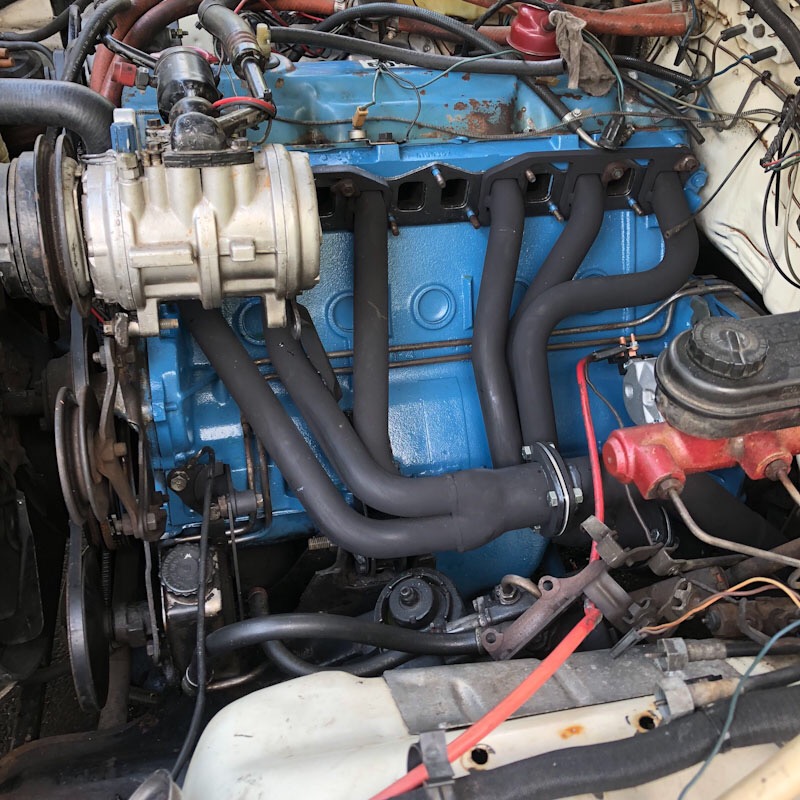

Questions remaining: seems like I’ve got a giant hissing sound—any thoughts on why? I torqued all the manifold bolts to the reccomended 5 ft-lbs. Maybe I need to go up on the torque?
Also, car idles nicely but has died s few times just sitting in park—and, frustratingly, died instantly every time I put it in gear tonight although it was warmed up and the choke was off. I suspect fuel pump or something’s wrong with the kickdown linkage. Would appreciate any ideas. Thanks!

Here’s a picture

Probably you have a vacuum leak at intake to head. 5 lb/ft probably not enough to seal. I just install the same get-up and torqued to 8 lb/ft. with the intention of, if needed, going to 10lb/ft. I replaced all studs, and used brass nuts with a dab of copper anti-seize on them.
Torque spec assumes clean drag free turning of nuts. I you used old studs and nuts, the actual clamping force exerted could very from stud to stud. In other words a 5 lb/ft reading on a freely spinning nut would have more clamping force than a stiffly turning nut with the reading.
Try 8lb/ft and observe compression of gasket. Tip #2 on Remflex package states; "gasket crush should be 50%."
What year is your car. I see a Saginaw power steering pump, and a very different bracket holding it in engine photo. Reason I ask is, I'm suffering with a TWR pump and goofy wracked bracket that required several hours of farting around shimming and fitting it so its pulley aligned with damper. If this red neck garage get-up don't hunt, than I just as soon convert to the much less expensive and simpler Saginaw arrangement.

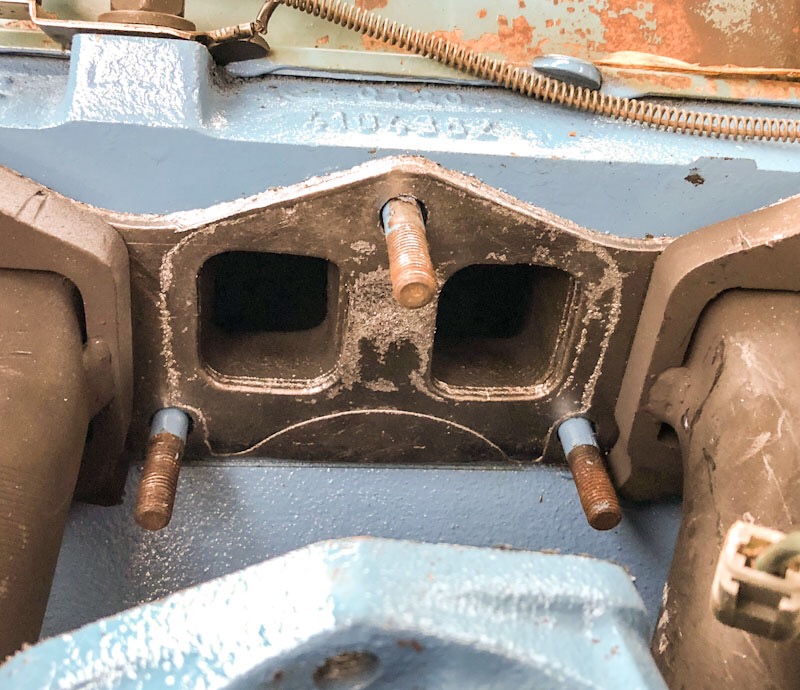

You likely have the intake or headers hanging up on something and preventing the flat sealing of the intake to the head. Also, the remflex may not cover the exh flange on the headers completely and allow an exh leak, but that would be a popping/farting sound, not hissing. You need to always put the int and exh on with no gasket and check for flat/parallel alignment before assembly. Remflex cannot fix misalignment. We just found a big hole on Brian Mimken's where the remflex meets the Clifford shorties and does not cover all of the flange opening.

You might consider moving the tranny cooling lines, they are very close to the headers it appears from the picture. Perhaps I'm not seeing it for what it is. If they are 1/2" or more away should be fine. I ran mine on the other side of the engine, along the frame, but I fabricated flexible lines.

Finally had the chance to take the intake manifold off to check for alignment, etc. I think I'm seeing that the top of the intake did not fully seal up--probably it was being pulled off line by the headers. Picture of the center section below. I disconnected the headers so the rest of the exhaust is not pulling on them. Seems that should help get a better seal across the top. Any other thoughts/tips/do's/don'ts? Hoping to get it together this week.
