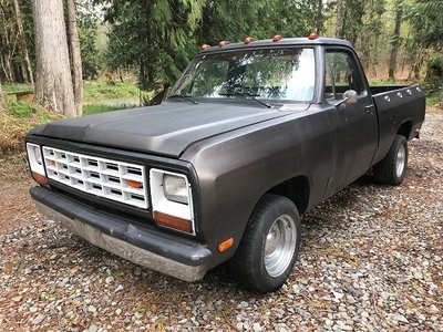

I just bought a nice 1981 D150, shot bed/single cab. Body's in great shape, no rust on the body, bed, or frame.
Wiring in the cab and engine compartment is hacked, but easy enough to fix.
Compression is not great, 125 highest to 100 lowest.

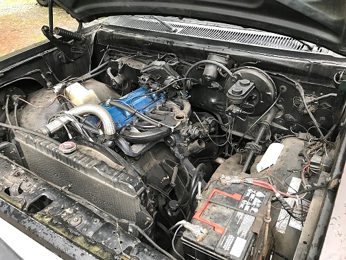

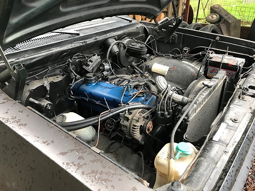

It still has the lean-burn and distributor, but the carb is missing.
I've read up on the info and advice here about removing the lean-burn, and I believe I have a good handle on the dizzy that I need (single pickup, vac advance, convert to HEI), but I need some help and the carb.
I've read here posts referencing the Holley 1920 and 1945, and also some others.
But I haven't seen any info re: which carb is appropriate for a given application.
This truck has the auto trans, no AC
My intention for this truck is the occasional week-end local driver, going to car shows, et al. Eventually will either rebuild this engine or go the resto-mod route with a 5.7 Hemi and drive train from a newer Ram 1500.
Please advise on the carb.

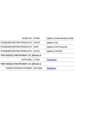

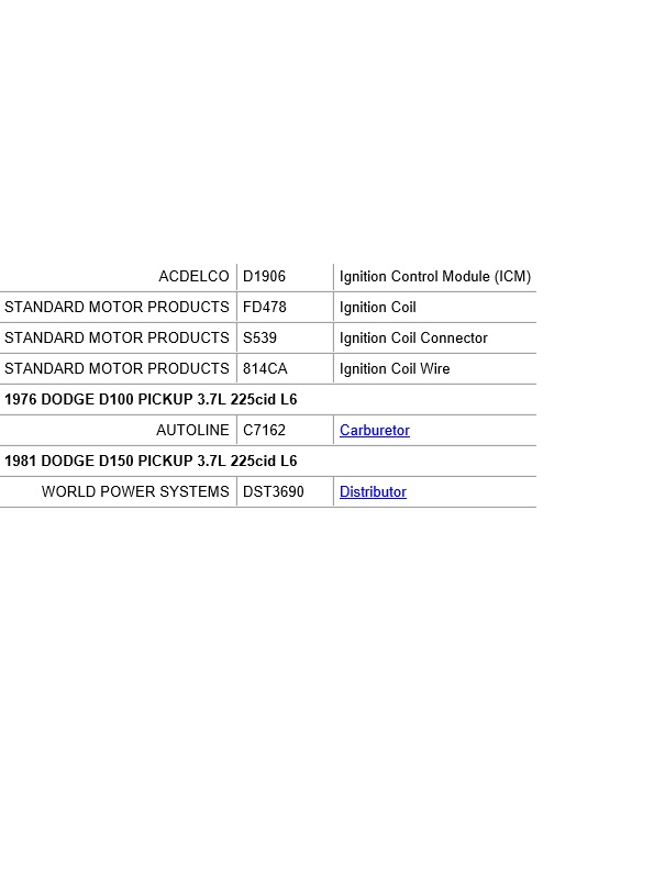

I ordered a carb, distributor, and the HEI parts from Rockauto.
It all went together well, with only a few issues.
1. The AC DELCO ignition control module failed after two days. I ordered another and it's still working.
2. Setting the timing was a real chore. This motor is very, very touchy. A couple degrees either way from the "Sweet Spot" and it won't run at all.
3. I had to fabricate a linkage arm from the carb throttle to the transmission kickdown. I used 8/32 threaded rod, four nylon lock nuts, and made up some bracket ends. The linkage is adjustable, more on that in a minute.
It's a little rough at cold idle, but once warmed it runs great!
About that linkage: is there a guide to proper adjustment?
When should it "engage", as is when and how much when the throttle is moved?
Thanks again, you are all a great resource of info to keep these on the road!
