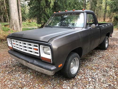

I just bought a nice 1981 D150, shot bed/single cab. Body's in great shape, no rust on the body, bed, or frame.
Wiring in the cab and engine compartment is hacked, but easy enough to fix.
Compression is not great, 125 highest to 100 lowest.
It still has the lean-burn and distributor, but the carb is missing.
I've read up on the info and advice here about removing the lean-burn, and I believe I have a good handle on the dizzy that I need (single pickup, vac advance, convert to HEI), but I need some help and the carb.
I've read here posts referencing the Holley 1920 and 1945, and also some others.
But I haven't seen any info re: which carb is appropriate for a given application.
This truck has the auto trans, no AC
My intention for this truck is the occasional week-end local driver, going to car shows, et al. Eventually will either rebuild this engine or go the resto-mod route with a 5.7 Hemi and drive train from a newer Ram 1500.
Please advise on the carb.
