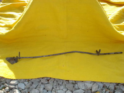

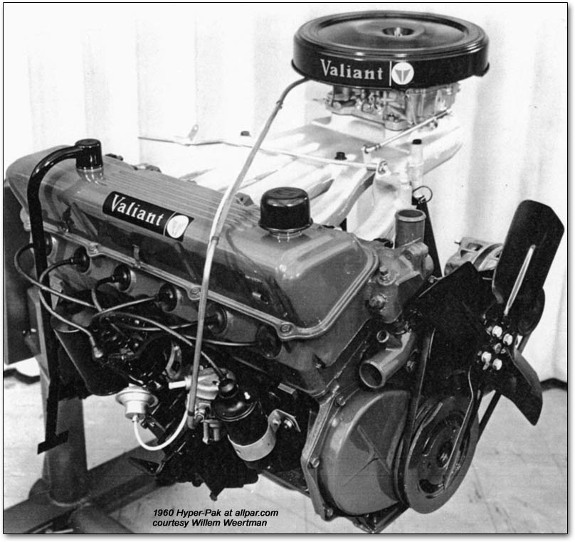

I have made some changes for safety, dual circuit MC, but I want the linkage to be as stock as I can. Keeping my pedal, and kickdown as mentioned. I have never seen stock linkage in person so I am working from photos. The long rod on the yellow towel has the kickdown linkage. Even the Daytona Valiant had a similar rod and it looks like they were using the kickdown as a return spring. I don't think the package was recommended for an automatic transmission. So some stuff I am experimenting with.

Stan, there is a 62 Lancer GT on EBay right now that has the Hyperpak intake and exhaust on it. It has some pics of the linkage.
