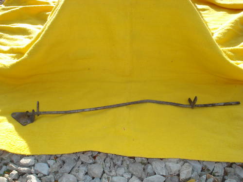

I have made some changes for safety, dual circuit MC, but I want the linkage to be as stock as I can. Keeping my pedal, and kickdown as mentioned. I have never seen stock linkage in person so I am working from photos. The long rod on the yellow towel has the kickdown linkage. Even the Daytona Valiant had a similar rod and it looks like they were using the kickdown as a return spring. I don't think the package was recommended for an automatic transmission. So some stuff I am experimenting with.

Clean install. My rotating rod is like yours but my linkage from the rod to the carb is different. It has ball and socket ends and adjustable rod?

62 Val, can you post a picture? If I look at the promo picture close it has the ball and socket style. The XNR and Asimmetrica have the other style, like a manual transmission to shift rod style. I am working on each, just looking for some small parts in the mail.
