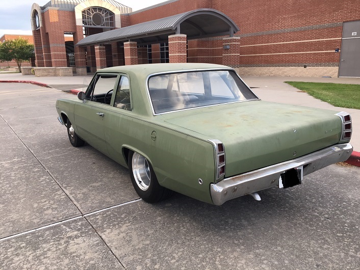

Made my first voyage today with the Valiant...the 13" rear tires were so dry rotted I was afraid to drive it fast or far. So...I had some 15" Nitto's off another car I decided to use. That required some surgery and a change to an 8-3/4" rear. The gears went from 2.76 to 3.91, too...though with the larger tires it's actually like I changed to 3.14's. A nice improvement in pep.
Next step is to finish the trunk (paint) then find a way to put matching wheels on the front of the car (going to 4.5BP).
I also got rid of the stock gas tank and went to a flat floor, no more spare tire well. The new tank provides way more exhaust pipe room on both sides as well as bigger fuel outlets in case I ever need them.

Thanks guys. Now I am thinking about tackling that pesky transmission situation...
Plus I probably have to go back into the rear end....the 3.91's are from a mail truck...I took them out around 1985 and they were rusty & pitted back then. I thought letting them sit for 30 years would fix that but it didn't....I knew they'd be a little noisy but they're NOISY so I don't see them being a long term participant.

Thanks again. The rear is actually 1" lower than it was 'stock' but the tires make it look higher.
Exhaust? Well....you'd need a really loud V8 - reeeally loud - to drown out those gears! They're actually quiet under acceleration, mostly. But in the transition from accel to coast, they scream pretty good! I have another 3rd member with 4.10's that are good so that might be the easiest way out.
