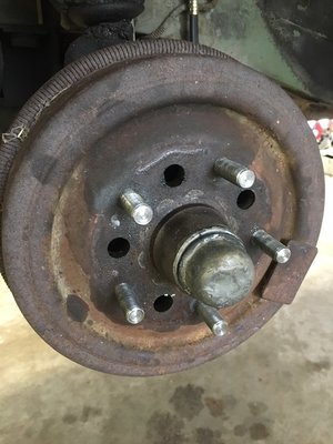

How do you do 9" drums up front with 5 on 4.5" bolt battern? Redrill the hubs / drums or adapters,
PostPosted: Sun Aug 04, 2019 7:58 am
Thanks. I redrilled the fronts. There's plenty of meat there. The trick, in my experience, is to never separate the hub from the drum. I drilled and tapped them together (1/2"-20)and installed the new studs before driving out the old studs. I didn't bother measuring runout with a dial indicator because...the eyeball indicator shows there is essentially no runout.
I have at least one complete set of good discs/spindles I could have used but I want to retain the lightness and compactness of the drums. If I ever get inclined I might change to discs but it'll be Wilwoods or something similarly light.
