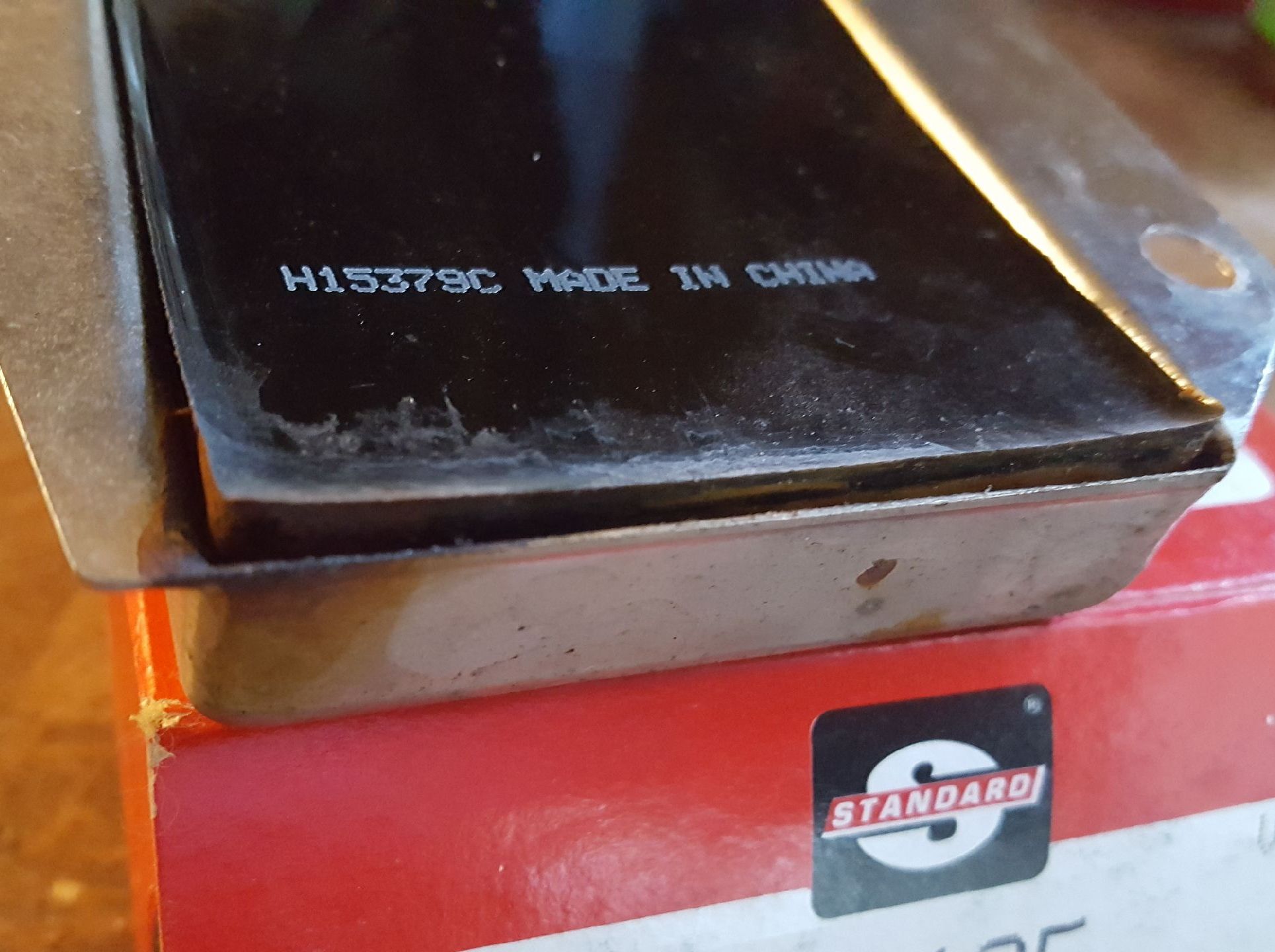

Found this upon further inspection of relatively new Voltage Regulator:

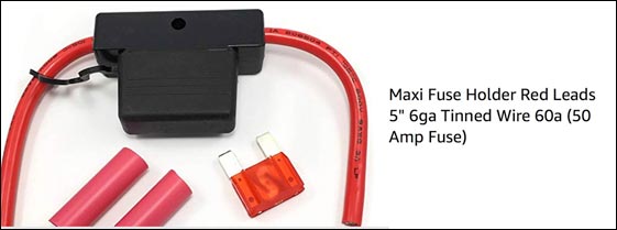

1) Ring terminals and fuses — any suggestions for specific parts (e.g. fuse holders)? I'm at a loss. For the fuse, are we talking about something like this?, with one lead at a ring terminal and the other connected to the 10 gauge cable? https://amzn.to/2LwEDVV or illustration
File comment: Fuse
Yep.
