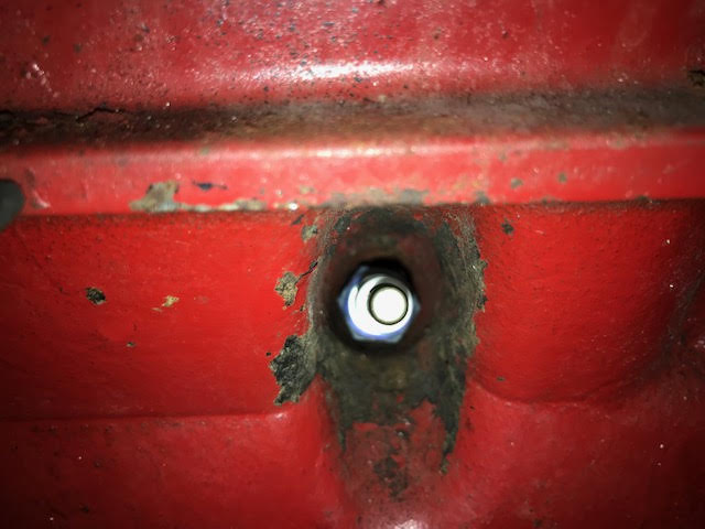

Thanks for looking into this for me. So I had a look below the number 6 plug and found an empty plate. Gonna have to pull the alt. and coil. to get a better look under number 1 plug. BTW the plugs sit more in an opening and less of a tube. .... but here's a pic or two maybe you'll find them usefull. I let yooou know when I have time to look under #1 plug

Cylinder head is 75+. Note it uses different spark plugs than earlier heads. That pic on the very bottom has the date code, should be able to wipe it off enough to read it. Zooming in I can see a few numbers but can't make them out. Also if you remove the valve cover you can tell if it is hydraulic or mechanical valvetrain. If rockers arms dont have a nut on top to adjust it is a hydraulic motor from the 80's.
VIN should be stamped on that top pic on the side where the rib is a little bigger. Not sure if they stamped VIN numbers on replacement engines or engines made for farm implements and marine use though.

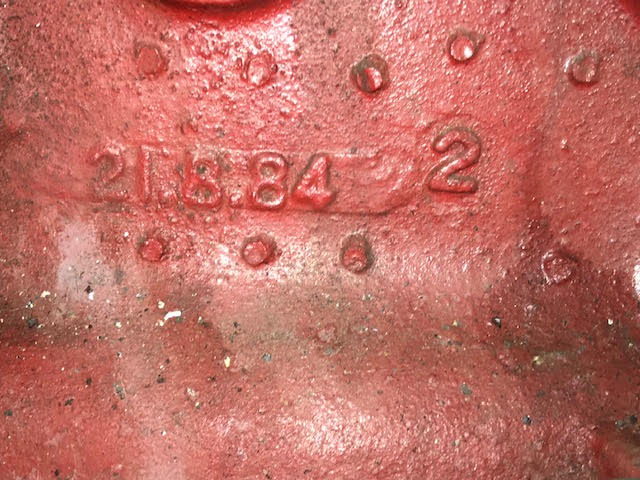

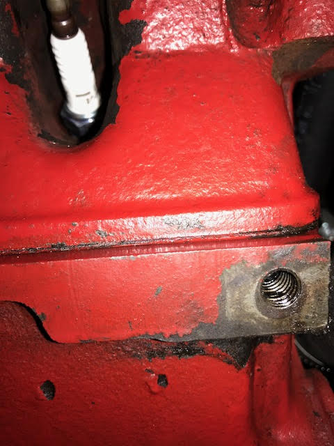

This has become quite the head scratcher.........after pulling the alt.,the coil and bracket I find yet another plank plate. I did find some more numbers on the front of the block but not sure if they are of any consequence. Didn't pull the valve cover but had a peek through the filler cap and it's hydraulic just as you had expected. The partial numbers you asked about are the same as in the very first pic I sent 12.8.84 maybe it's the build date. Could be that this engine was an industrial/marine application......that might explain the lack of markings. If that is the case, where do I go to find info for that series of engines?

In your second picture I see the outboard side of the pad. The number, if any, will be stamped on the skyward portion of that pad. If the block deck has ever been resurfaced the number is likely gone.
What having a later engine in your Valiant means in practical terms is just that you'll use different spark plugs. If your car retains its original distributor and carburetor (or accurate replacements) a tune-up will be to the original specifications, but hydraulic valve gear will eliminate the valve lash/clearance adjustment. The hydraulic head was wider and so was the valve cover and gasket. And if major engine work is ever required you will need crankshaft bearings for the later engine.

cleaned that rail spick and span and wouldn't you know it there was nothing on it besides the paint. I guess the only thing left to do is pull the distributor match it up best I can with year models and go from there. She runs good on the new plugs I put in gapped at .035. Not sure what to gap the points at. The timing band is the tube style and I believe the advance is 10-12 BTDC at any rate it runs well set there. Gotta replace the vac advance pod on the distributor I'll see how it runs then.

I forgot to mention the date code you asked about is the same as on the other side 12.8.84

I guess the only thing left to do is pull the distributor match it up best I can with year models and go from there... Not sure what to gap the points at.
It's a late 1984 engine from the 1985 Model Year...If the distributor is points its most likely original to your car, since points ceased to exist in vehicle distributors about 1972,
and in the 80's vacuum advance and mechanical advance was not as common with the use of the ESC computer. Josh kinda hints at it, but most likely the previous owner
tanked the original engine and replaced it with a late cast crank peanut plug head 225 slant six, then probably installed the 60's distributor, carb, etc to get it back on the road.
