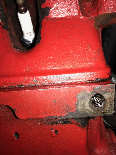

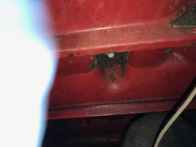

This has become quite the head scratcher.........after pulling the alt.,the coil and bracket I find yet another plank plate. I did find some more numbers on the front of the block but not sure if they are of any consequence. Didn't pull the valve cover but had a peek through the filler cap and it's hydraulic just as you had expected. The partial numbers you asked about are the same as in the very first pic I sent 12.8.84 maybe it's the build date. Could be that this engine was an industrial/marine application......that might explain the lack of markings. If that is the case, where do I go to find info for that series of engines?

In your second picture I see the outboard side of the pad. The number, if any, will be stamped on the skyward portion of that pad. If the block deck has ever been resurfaced the number is likely gone.
What having a later engine in your Valiant means in practical terms is just that you'll use different spark plugs. If your car retains its original distributor and carburetor (or accurate replacements) a tune-up will be to the original specifications, but hydraulic valve gear will eliminate the valve lash/clearance adjustment. The hydraulic head was wider and so was the valve cover and gasket. And if major engine work is ever required you will need crankshaft bearings for the later engine.

cleaned that rail spick and span and wouldn't you know it there was nothing on it besides the paint. I guess the only thing left to do is pull the distributor match it up best I can with year models and go from there. She runs good on the new plugs I put in gapped at .035. Not sure what to gap the points at. The timing band is the tube style and I believe the advance is 10-12 BTDC at any rate it runs well set there. Gotta replace the vac advance pod on the distributor I'll see how it runs then.
