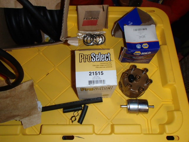

If I have to stay home I might as well enjoy myself.

Check the underside of that distributor cap carefully before you use it; those Echlin MO-40s are often ground off-centre. There's a link to a thread about distributor caps along with the tune-up parts and technique suggestions in this post.

Dan I bought this cap because of that thread. Can you give me the right cap to buy, PLEASE. I bought the Eschilin rotor,

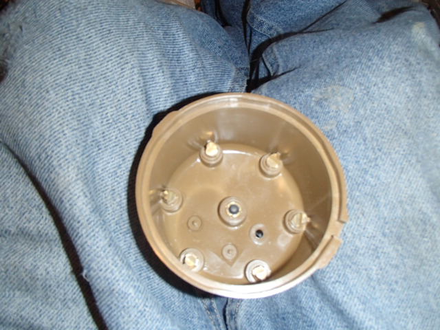

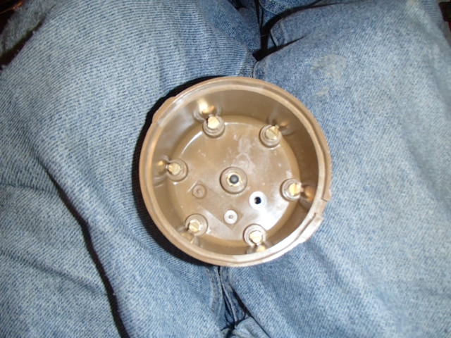

Dan here are 2 pics

Tough to tell from here. Look at all six of the brass lugs, see how they're ground down from a full circle? You're looking to see if they're all pretty much the same half-circle. The off-centre ones have some as a smaller sliver and some as more than half a circle.

Dan, the plastic down around the base of the brass posts have slivers of brass and plastic hanging. I can defiantly see that the brass posts have different circumferences. What is my next option for a cap??? I finally got my VC gasket from NAPA and it ended up being a cork instead of rubber. I'll make it work.
Amazing. I first noticed this problem on the Echlin MO-40 caps around 1992, and sent a couple of them and a detailed letter to Echlin at that time. They said "we don't see a problem with 'em". Nearly two decades later, they still don't give a carp.
Best read this entire thread. Long(!) but worthwhile.

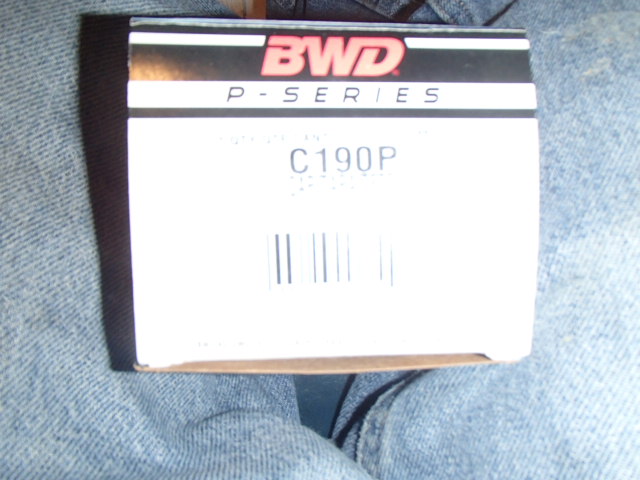

Buy this one https://www.ebay.com/itm/143531545193 or this one https://www.ebay.com/itm/123867227646

I went to Advance and bought there's. It was cut correctly at least by the naked eye. I will make note of the 2 you listed to buy.
