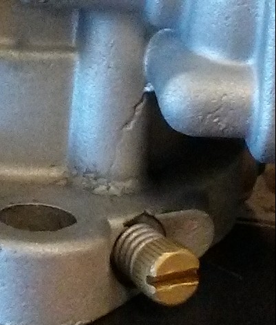

As I've seen in this thread remanufactured carbs are usually a step in the wrong direction, and for good reasons. The carb I have (other than the annoying leaky bowl I plan to fix with a doubled or thicker gasket )works ok for now. Considering the fact that the 1920 Holley is becoming more obsolete I'm thinking about getting one(remanufactured, for when not if mine wears out), at least I would have a shot at a diy rebuild if it doesn't work properly. The biggest concern at this point is in the picture I've attached; is it a minor casting flaw or crack? Any thoughts?

Crack or flaw, that carb has been sandblasted, which means the passivation coating is gone, which means it will sooner than later be a useless lump of powdery white "metal mould" corrosion.
One cannot undo the badness of "remanufacturing" by taking the carb back apart and putting a kit in it. :-(
