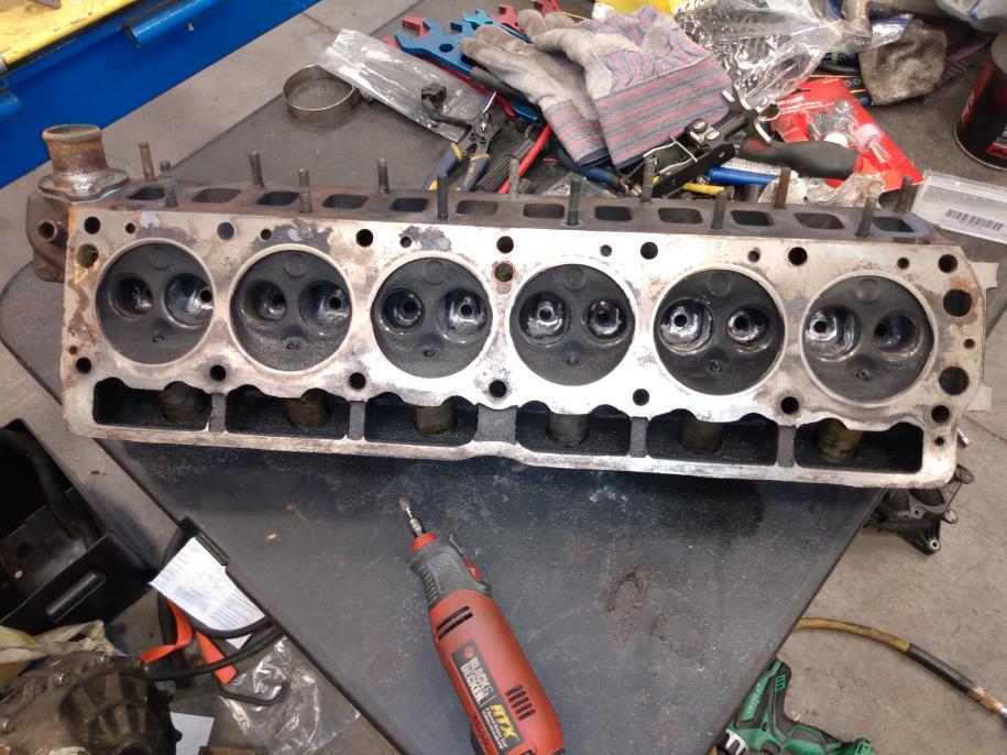

Finally back on this one. The cylinder head has been ported and gasket matched, as has the intake. The exhaust manifold did not need any gasket matching.
File comment: Cylinder head porting
Then I dropped the head off at the machine shop for a valve job and cutting the valve guides down for more clearance and positive type valve stem seals. Still waiting on that.
