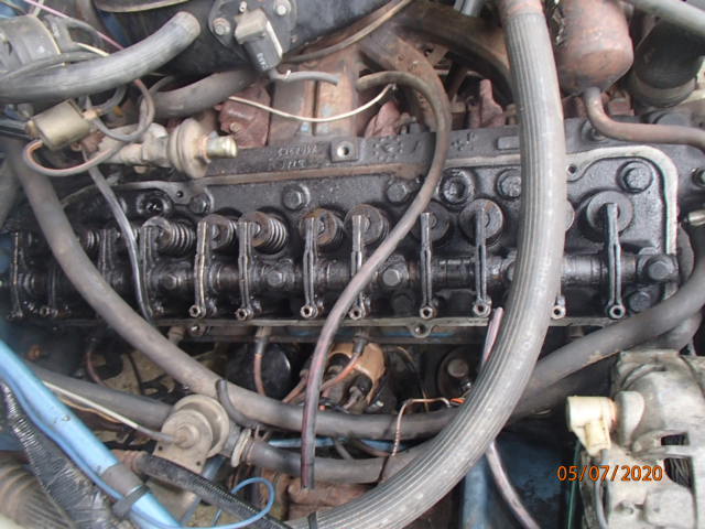

Thanks for the quick response. 27k original miles. It has adjusters. I have to rig up some hose and wire pull ups. Its not like adjusting valves in my '61 Dodge Seneca with all the room in the world.

On my 79 Volare Wagon, I adjusted them hot, .010 intake, .020 exhaust. I adjusted them after the engine warmed up but not while it was running. That worked well for me.

I do mine by the manual. Running with SNOT FLYING. LOL

I have only done mile once at about 22,000 miles. Warm engine idling away, went OK just a little oil flying about.
