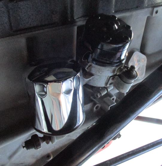

Dist fits, however I can't get the oil pump in or out, it hits the frame.
More thinking...
So here is the latest progress, man this part is fun!
Trans in place, block plate in the correct location, 30 degree tilt done.

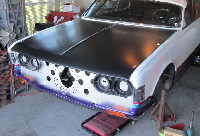

Figured out if I kick the front of the motor over a couple of inches, I could get the pump in. So I put all the stuff on the motor, put the front end back on with the hood and I have a 1/4 inch between the hood and the front breather. So I used the Offy valve cover and it has a pretty high standpipe. So if I cut a 1/4 inch off of that I will have plenty of clearance. First picture is everything installed and hood on, it fits! Now for the Headers....

Will tilting the engine have much effect on the clutch and transmission linkage?
PostPosted: Mon May 18, 2020 9:38 am
Posts: 2701
Badvert, the engine is at the 30 degree tilt as designed. The bellhousing is square with the frame, so all that stuff is right were it should be. The transmission rear mount is square to the rear crossmember. I am going to use a hydraulic throw-out bearing because I don't want to fabricate a bunch of linkage and rods in the close space I have.
Is that what you were asking?
