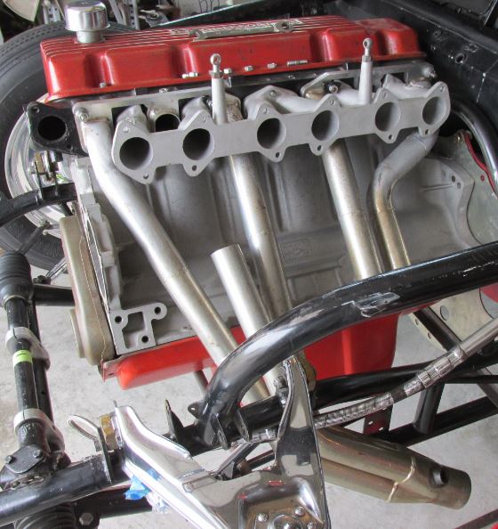

PostPosted: Sun May 31, 2020 8:37 pm
Posts: 2621
Started cutting pipe. I thought just one of the last three would need fitting, but it looks like all 3 will have to be changed. I am also going to remove 2 pipes from the head flanges to clear the Clifford intake.

PostPosted: Mon Jun 01, 2020 4:20 pm
Posts: 2621
I feel like a 90 year old man today.
Does any one remember the header Ad from years ago?
It was Hooker or Appliance or another one and this poor guy was under the car with pipe knee high.
The caption says, "Mike Failed Today"
That is how I feel today.
This is where I stopped for the day.
