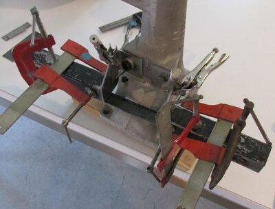

Finished the transmission mount. Here is it clamped up before welding.
The second picture is one side of the mid plate tabs, also the notched mid plate tube.
The engine goes all the way to the firewall and between this tube notch.
I should finish all the other side tomorrow.
I am then going to start putting the car together to go over to the Dallas Mopar Show.
Just want to get it out of the garage and into the daylight.
I just hope it doesn't rain like last year!
