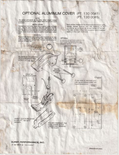

Posts: 2626
Hello Slanters
Finished working on my Norton for this year. It's ready to start, but I am waiting till next spring. I don't want gas sitting over the colder months. Major tasks were new paint on tank and sidecovers, transmission reinstall, new wiring, exhaust system. real happy how it turned out.
Started back on the Colt yesterday! Yay!
I needed to realign the drivers door, it's a touch low and the quarter window is in to far at the bottom.
I removed the quarter interior panel and I found a Hurst QuarterStick installation document in the quarter.
It's dated 1990, wish it could talk.
I need some cats wisker material to fill the window to quarter panel.
Lots of air getting in there.
Maybe that is how the instructions got in there.
Dana out next for new rod end bearings and clevis on ladder bars.
Small leak somewhere, need to find and fix.
Also need to remove axles, figure out the disk brakes I need to purchase.
More to come.
