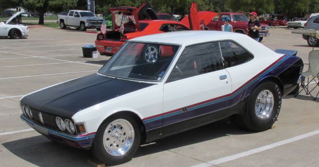

PostPosted: Sat Sep 05, 2020 5:42 pm
Posts: 2624
I put the car back together and took it to the Mini Mopar Nats in Rockwall Texas today.
The little car was well received and it looked good in the daylight.
I was fortunate to take 2 Place in Race Car.
Only one person called it a Datsun, but he turned red when I told him it was a Colt.
The slant was a hit, lots of complements on the unique engine.
