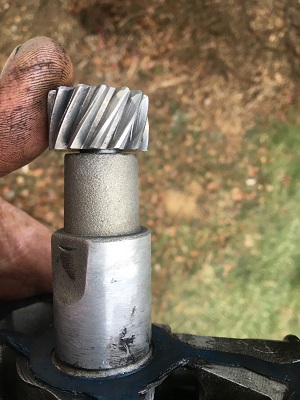

I am sorry I don't have good news on the oil pump gear. As I mentioned over in my truck thread in the Virtual Dragstrip section, I had a whine that I was attributing to the chain guide I installed in the timing cover. However after getting the oil pump out and looking at the gear, I believe the noise I hear is the oil pump gear. Or at least that is a possability. Here are the pictures of the oil pump gear after @ 1 hr 40 min run time. Gear pattern is wide across the gear face but it has already started cutting into the gear and I would suspect the cam as well. I will try and get Ryan's snake camera and see if we can look at the cam gear a little better.
I hope Doug sees this and chimes in on what he thinks, and what I should do next. I would guess reassemble evertything and run it for a while and pull it again. Maybe 500 miles or so? I did cut open the oil filter and found nothing inside to indicate my chain guide was a culprit.

Hmmm. I still haven't got mine installed yet, due to life and other things, but I still am hoping to get it installed soon. Did you do any kind of lapping or use assembly lube when you installed it?
Can you post a more high-resolution and larger photo? It looks like the pump drive gear is quickly wearing away.

No lapping but I coated both gears with assembly lube. Yes the gear is wearing
Click this photo. That is as large as it will allow me to upload.

That's alot of wear...
:cry:
PostPosted: Sat Dec 26, 2020 5:56 pm
Ooof. I would not put that back. Fingers crossed the new cam is okay.

A lot of wear for the short amount of run time... :(
Do not run that gear any longer, it's going to eventually fail.
The good news is that the contact pattern seems well centered.
The pressure readings are lower then I like to see but this is the smallest impeller pump. (5/8)
I am wondering about the whine sound... I did not hear that with the one I tested. :?
We need to re-look at the gear tooth geometry.

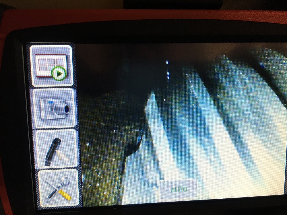

I did use the scope today to try and get a better look at the cam. As always(for me) looking into a hole with bad eyes with poor lighting options and limited room makes for a bad combination. On top of that, these are pictures of the scopes screen. I could not figure out how to get it to take a picture.
I know these are not good but it did look to me that the wear on the gear was not terrible. Although none would be better I could not see anything that will keep me from running the cam. I got a good Dutra pump with the extra spray tube and a very nice well used gear. I already assembled it and will probably try and get it back together and running Monday. Once it is back up and running I should be able to tell if the whine is gone.
The wear I could see did not appear to be in the middle of the cam gear.
It also appeared to be up higher on the tooth. ( To the outside)
Doug just let me know if you want the pump sent back and to where. I know you have a lot going on so you take your time. It can set here as long as need be.
