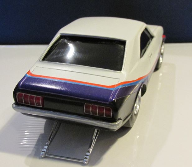

I have a friend down here in Texas, Bama Brown. Radio talk host with KASE, Dripping Springs. He is a pretty neat guy. He has been on Iron Resurrection TV show and he is building homes for First Responders on his property. Anyway he told me he had something for me and this showed up in the mail today. It's a scale model of my Colt! I was blown away as I unwrapped the packing. Who does that anyway? And oh by the way, we are face book friends, I have never met him face to face.

Very cool! There are still people in the world like that. Nice to see.
PostPosted: Sat Jan 16, 2021 5:18 pm
Posts: 14848
That is awesome!
