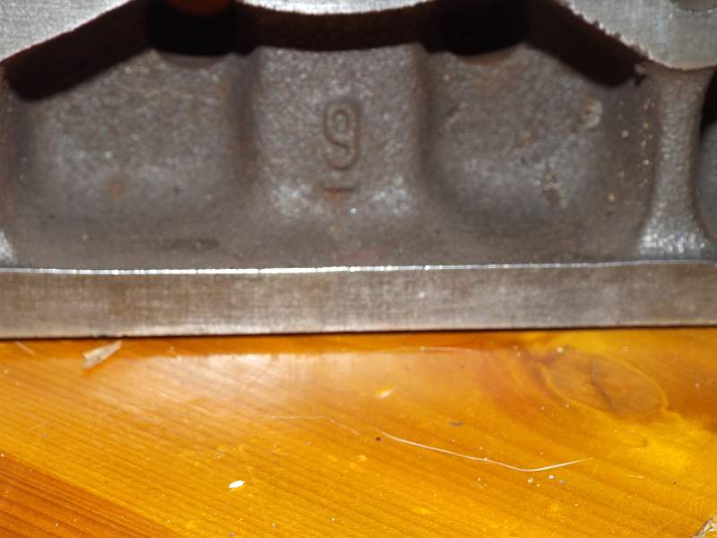

Here's a number "9" cast into the head. Probably coincides with the -9 at the end of the casting number I would just "guess".
