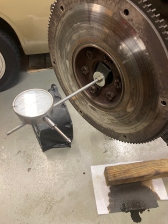

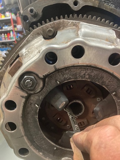

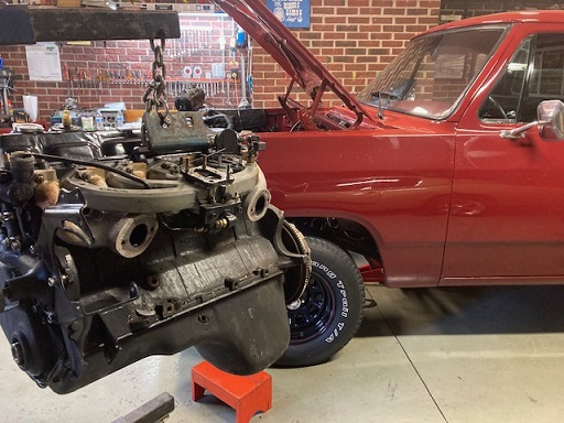

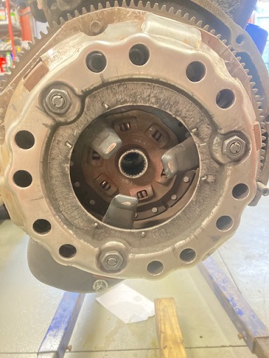

Pulled the motor from the 83 D150 yesterday. I had changed out the clutch - pressure plate and TOB in the summer of 2017 due to the plastic TOB housing breaking apart.
As time and use went on I had to adjust the clutch several times to get the the transmission to shift properly. It would shift fine the first couple of miles, then as things warmed up it would be more and more difficult to shift with out some gear crashing, So I would run the TOB in some more and it would be ok for a while. Finally got to the point where the TOB was running on the clutch plate fingers.
I know that is not right.
With the clutch plate mounted on the flywheel I measured and found, from high to low a .260 difference among the clutch plate fingers, measuring from the shinny point of the clutch finger where the TOB runs to the OD of the splined center section of the disk.
I can see a visual difference in the heights of the adjusting nuts - studs that are used to set the finger height. They are certainly not finger loose, but it appears that they are not locked in place and are changing while in use.
So I am clutch package shopping again.
File comment: measuring finger height
File comment: difference in finger height adjusting studs

I've had the clutch fingers go out of adjustment myself. We're at a point in time where 3-finger Borg and Beck clutches are severely dated. There used to be clutch and brake rebuilders all over who understood this stuff, but not so any more. A good friend was given a clutch cover fixture for adjusting clutch covers like the B&B. If I had the fixture I'd be tempted to fix something like this myself, but it's less labor to buy a new kit with cover, check the finger height and spot weld the adjusters so they stay put.

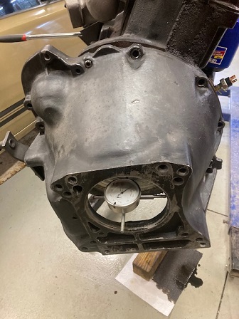

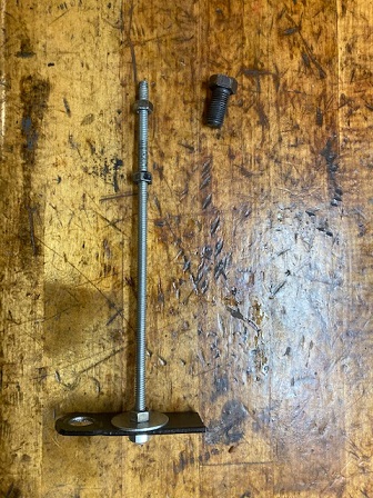

working to make everything as good as it can be, among other things went through the bell housing bore alignment.
I have a magnetic base, but I always bump or move it when removing the bell housing for a recheck. Made the fixture shown in the photos below,
rigid enough to be repeatable, does not get in the way of removing - reinstalling the bell housing.
I put in a set of the robbmc dowels, these are nice pieces easy to work with.
https://www.robbmcperformance.com/products/dowels.html
I have the bell housing bore 0 to 0 East to West and .005 to .005 North and South.

I like your fixture, John. Thanks for sharing.

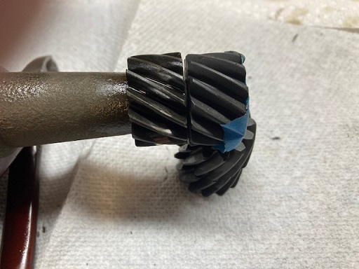

the replacement positive valve seals arrived today, so I will re assemble the cylinder head tomorrow.
The plan is to get the engine back into the D150 mid next week.

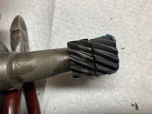

Shown below is the oil pump drive gear from the 83 D150 and setting next to it is a new never ran oil pump drive gear.
The pump is a D Dutra ported pump and the gear that came installed on it is one of Doug's hardened gears.
This pump has a few miles short of 50K miles on it and it was running against the helical drive in the OE 83 D150 cam shaft.
When I had that cam shaft re ground it already had 100K miles on it prior to the regrind so the cam shaft drive has around 150 K miles on it.
The oil pump gear has obvious shinny spots where the two gears meshed together but from my visual observation and visual comparison to a new un used gear the oil pump drive gears shows minimal wear. Hopefully it stays that way running against the NOS Mopar Performance cam shaft
