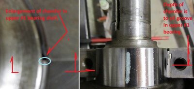

Started doing research and I see the timing chain slack is a common issue for jumpy timing, so since the radiator's out and I've got a wobbly dampener anyway, I pulled the front of the motor off and I definitely have a loose timing chain. Worse, it looks really dry... it's definitely NOT been getting oiled for.... a while. On the Sweptline Facebook group, a helpful member there pointed me to http://www.plymouthcarclub.com/2015/12/ ... in-oiling/ describing how the original bearings had a chamfer to provide oiling at the crank, with an alternate solution of custom drilling a galley plug.
My primary question at this point is... if I am removing the #1 bearing cap to inspect/clean out that chamfer, and find the upper bearing DOESN'T have the chamfer, is there a technical/engineering reason to not put the chamfer on the LOWER bearing cap since I've got it off anyway? (ref: blue circle in attached photo). I fully admit I'm not an engineer, but I have a fair amount of common sense and this seems (particularly given the tiny surface area being affected), like it couldn't have any real negative side effect, and prevents the need to take the crank out of the motor!

My primary question at this point is... if I am removing the #1 bearing cap to inspect/clean out that chamfer, and find the upper bearing DOESN'T have the chamfer, is there a technical/engineering reason to not put the chamfer on the LOWER bearing cap since I've got it off anyway?...
The top bearing insert has the oil feed groove and the bearing's locating tab, facing forward so it is just easier to add the chamfer to that bearing half when the bearings are not installed.
There is no reason why you can not add this oil pathway to lower bearing half but just go forward with the chamfer, from where the top oil groove meets it. (just chamfer 1/2 of the edge, away from the tab)

Understood on the chamfer being only the front half! Definitely cautious wherever affecting oil pressure is a factor.

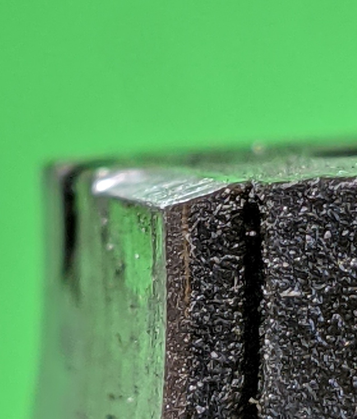

So I took the #1 cap off this evening and found no chamfer on any of the main bearing edges. I placed a small chamfer on the lower bearing as previously discussed (yes I cleaned up the shavings!) And retorqued the main bearing. Crank still spins nicely. Now the question is... When I fire this up the first time, is there any reason I must install the timing cover? I'd like to actually see if the oiling is working... Or not... Before I button it all up.
My new radiator and the other various gaskets and parts got here finally as well so my goal is to get the timing set installed and hopefully degreed (though I'm not willing to pull the head at this point, so not sure how doable that is) and then see if I can get it to hold solid timing. At this point I'd settle for running decently without overheating. I'll worry about making it hotter later on. I've been doing some reading and I like the idea of doing some mild breathing modifications over the winter. Will see if the budget agrees... Got a lot of irons in the fire at the moment.
