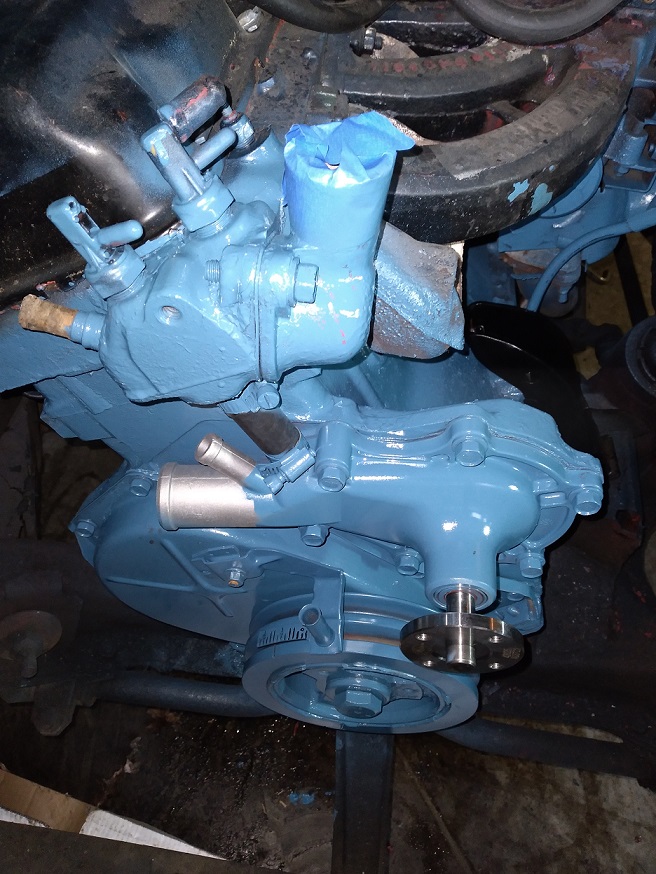

Made some good progress today, I cleaned and painted the left motor mount bracket while Logan was in school. When he got home we did a lot of cleaning and painting, installed the left motor mount bracket, installed a repair sleeve (groove in damper where seal rides) and installed the harmonic damper. A few days ago I detailed the timing mark bracket to easier see the marks.
Tomorrow the carb comes off to replace the leaky carb to intake gasket. Will probably do some cleaning of the intake while the carb is off, and paint it blue.

File comment: Front painted
File comment: Side painted

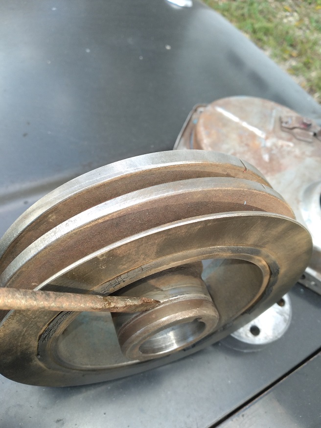

File comment: Installed repair sleeve
File comment: Groove in damper
