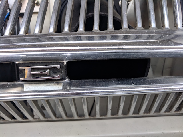

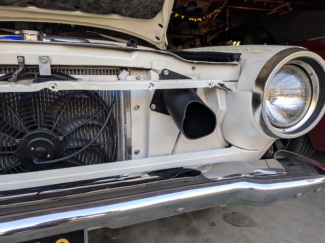

Added some pics of my custom ram air to the CAI. Not sure if it helps, but if it is good enough for a Hellcat, then its good enough for Rodger.
