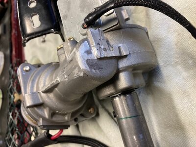

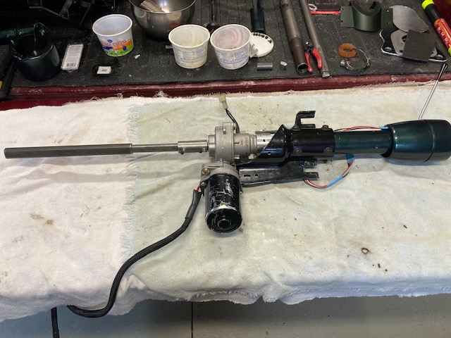

An update, I have been working the EPAS install as a winter project, I need to get it done, but no real rush currently.
In working the install on this kit and speaking with the Engineering person (Geoff) at EPAS Performance, it quickly became apparent that they had never actually installed this kit in a second generation Barracuda. When I ran into an issue and spoke with them on the phone, the directions they were telling me to take, simply would not work. I asked directly if EPAS had actually installed this kit (which they say fits a second-generation Barracuda) in a second-generation Barracuda. The answer was "No, we believe it will fit, but we don't do a test install in every car that we think the kits will fit". And that's OK, being a Slant Six Mopar guy, I am accustomed to have to do some garage engineering. EPAS has been helpful, one of the hollow double D sections that would likely work in a 1st generation Barracuda is too short for a second-generation Barracuda, I spoke with them over the phone, and they mailed a longer section cut to the length that I needed at no charge.
So I do have the EPAS unit installed on the steering shaft. Initially I was trying to set the power unit to the left of the steering column, like is shown in the directions for a 1st generation Barracuda, however that location either blocked the driver side fresh air vent box, or if moved up higher, interfered with the cable cam assembly that is part of the emergency brake. So I shifted it over to the right side of the steering column. To make that fit I had to cut the under-dash saddle bracket that holds the steering column up and in place. I can add an extension to the saddle bracket to recover the mount.
The power unit is just above the top of the gas pedal. I have the drive side seat out to make access easier. I reinstalled the seat and verified that the location of the power unit will not interfere with foot access to the go pedal.
I did some grinding on the back side of the power unit. The way things came together it hits there on the brake rod mounting bolt, I think with a bit more clearance added I can clock the power unit up another 1/2 an inch or so.
I have powered the EPAS unit up and it does make it easy to turn the steering wheel with the car stationary in the garage. I think that this will be a nice help on getting the steering wheel around on the tight low speed chicanes that I encountered while autocrossing last year.
I need to
1) fab up brackets to hold the power unit stationary with the steering column.
2) do the final assembly of the column with Loctite on the set screws
3) mount the electronic control box and finalize the wiring.
There is still so effort to put into this, but the tricky parts are done.

Then photo below shows the interference. That is where the unit is contacting the brake rod bolt. I will add more clearance and perhaps shift the power unit up.
I am certain that if this kit was being installed in a car that had the dash completely disassembled, this process would be much easier. So far this has been a workable and interesting project.

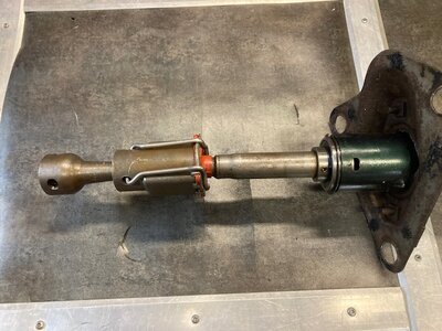

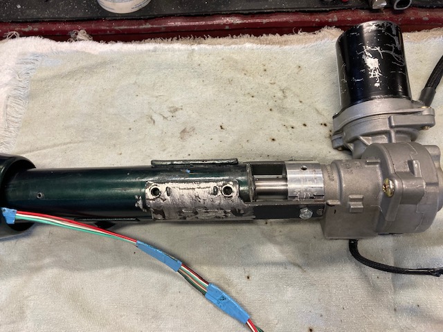

Incremental progress:
The motor assembly needs to be held firm with the steering column, so steering inputs via the shaft are fully read by the torque sensor.
Welded extensions on to the existing column mounts, then tapped the motor hub and bolted the extensions to the hub so the motor and the steering column are rigid together.
That all fits nicely with in the steering column mounting bracket.
I also shortened the upper steering shaft an inch. That moved the motor assembly forward and eliminated the close fit between the brake rod bolt and the back of the motor assembly.

another bit of information on my install.
The EPAS drive motor is mounted using the top section of the OE steering shaft cut down to length and two new double D sections of shaft supplied in the kit for the lower steering shaft section.
The kit includes the couplings that connect the shafts to the motor.
The couplings are secured to the shafts with set screws and Red Loctite that is included with the kit.
In the event that a set screw loosens or looses grip, the upper steering shaft section is not going anywhere. The upper shaft is held to the column by the inner and outer OE C clips and the column is rigidly mounted to the motor via the straps that I welded and bolted in place.
The lower shaft has no secondary support. If the set screws lost their grip at either the motor shaft or the small double D shaft, the small double D shaft could disengage and slide into the large double D shaft that passes through the fire wall and connects to the steering box. The sliding action of the small double D shaft into the large double D shaft is what allows for the slight in and out movement of the steering shafts under normal driving and the collapse of the steering shaft in the event of a heavy front end collision.
I drilled through the coupling and small double D on the shaft end and the coupling and splined motor shaft at the motor end to allow the installation of a small through bolt to provide secondary retention to the lower shaft. The transmission of the turning torque is still done by the fit of the small to large double D shafts and the splines. The added pins are there to hold the coupling secure.
