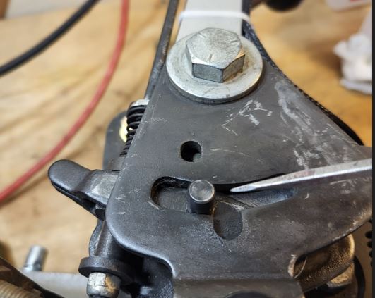

Posts: 2640
Transmission is ok, everything looks ok.
I did some thinking on the shifter, may have found a little help there.
Like the other problems I have addressed, won't know till some track time.
This is the 1-2 shift pin that runs in the slot and drops into the gate to shift 3-4.
It's pretty shallow to me, so I moved it forward.
I got stuck in 2nd at MOKAN.
Weird.

What kind of shifter are you running there Stan.. Looks unfamiliar to me.
PostPosted: Mon May 15, 2023 5:45 am
Posts: 2640
Hurst Ram Rod.
It's an inline shifter, not an H pattern.
Has a separate Reverse Lever.
You lift a lever to engage 1st and then it's just back, forward and back again.
Sometimes.

Posts: 10276
Got it.
More custom than what I am used to.
Good luck getting it sorted out.
