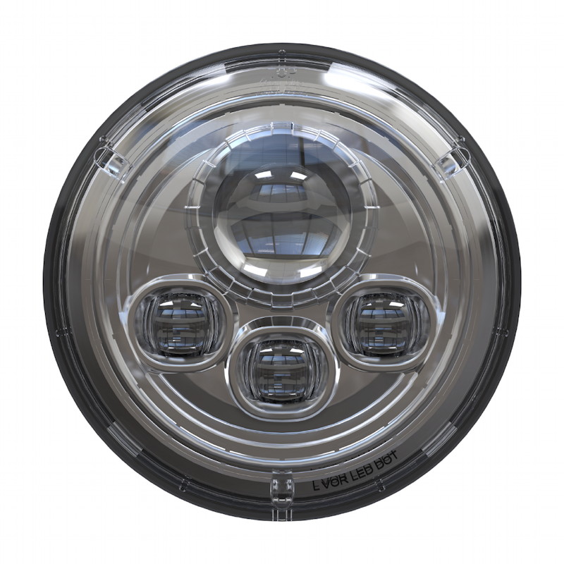

The over-and-under reflector types (the Philips item, the previous-design Truck-Lite, the Peterson 701C) don't have the spider-eyes look. They don't look like sealed beams, but they also don't look too much like they're off a space ship.
Is there something about the LED light output that requires the LED lamps to have a lot of smaller lamps instead of one big one
Well, LEDs are fundamentally different to previous kinds of light sources in ways that require different kinds of optics. If I had a magic wand to whip up cylindrical LEDs the size and shape of a filament and producing at least as much light with even more magical heat management, then we could have new-tech headlamps with old-fashioned looks (and suddenly it would be possible to have 1:1 LED bulbs for headlamps and brake lights and such that would actually work safely and effectively). Also I'd quickly become a billionaire. Then I'd have to money my way in as CEO of an electric-car company, take it over as dictator-for-life and immediately start claiming I'd started the company from the very beginning, and make extremely dangerous, shoddily-built, spyware-on-wheels cars while claiming they're the safest and bestest ever in the whole wide world. I'd have to spend 44 billion dollars on a social media platform and corrode it to worthlessness using only my mouth. I'd have to have a kid and give it a name like X-Æ-2QP3m5X. I'd have to pretend inheriting wealth from my Apartheid-South-Africa emerald mine owner father was a skill set.
