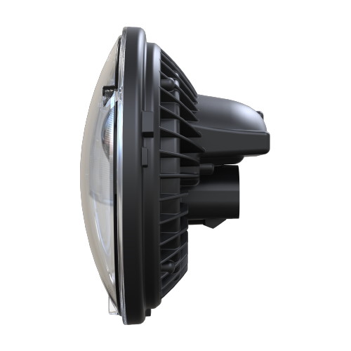

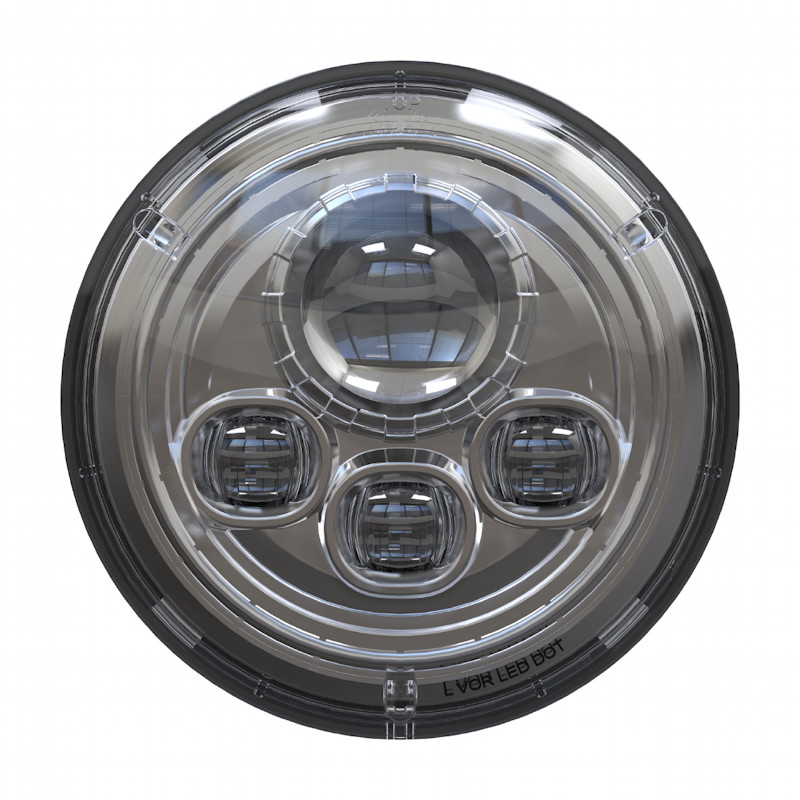

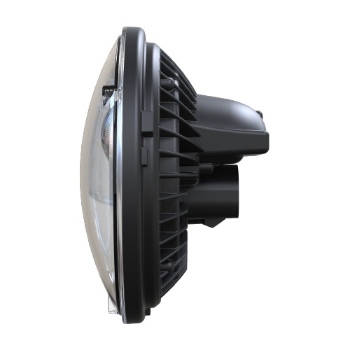

Yup. There is one (and only one) legitimate set of LED 5-3/4" sealed beams that actually fits and works. Commercial-grade items beautifully made in Korea. Pics attached; as far as I know I'm the only one handling them—send me an email ( dastern@torque.net ) for details. The JW Speaker 5-3/4" items do not fit in place of sealed beams; they have a much bigger rear body that won't fit any sealed beam mount cup.
