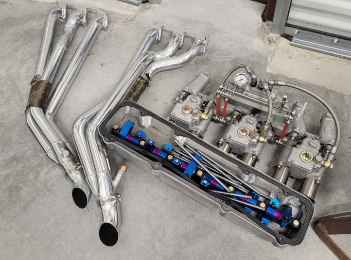

PostPosted: Wed Jan 10, 2024 4:59 pm
Posts: 2632
After the Holidays and finishing some shop wiring and lights I got some time to start.
The Autopsy has begun.
