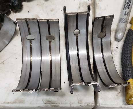

Didn't stamp them with numbers. Used an auto center punch and made dots 1 to 6. Got everything out of the block. Used an egg crate for the lifters. Got the idea here.
Picture of the main bearings.

Measured the main crank bearings at 2.190, 2.1875 is max in the SM. Maybe my mic is a bit off. The connecting rods checked a little big as well. I'm going to pull the valves tomorrow and check the head. Plan to haul it all to Midwest machine in Tulsa Monday.
I talked to the main guy there today. He mentioned they did a bunch of slants back in the day for Southwestern Bell. He wasn't familiar with milling .1 off the head/block though.
So do I have them order pistons? There is a ridge on some of the cylinders so it most likely needs bored.
Anything else I should look at?
