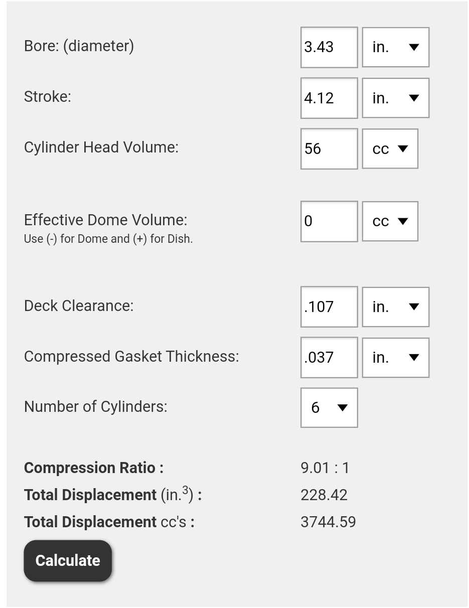

Not sure what changed but refigured just now and get .05 off the block for 9 to 1. Assuming I go .03 over on the pistons. If material is removed from the head the block will be decked less. I found some older threads here about pushrod length. Still searching and reading. I'm tempted to stay stock. :shock:

Was putting this info in a different calculator the other day. Don't think I was getting 9.4. .09 deck height would be. 067 off the block.

I would be careful trying to go over 9-1 CR on a street engine, with a very mild cam. I have a 170 engine with 9.5-1 CR and the mildest MP cam. I had a hell of a time tuning, to prevent detonation with less than 93 octane.
