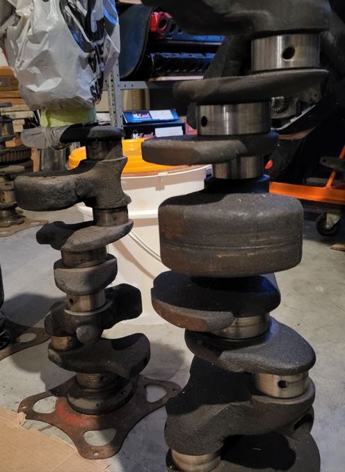

Here is a picture of what I call "Big" and "Little" cranks.
Both are early small converter/flywheel register flanges.

PostPosted: Wed Jan 31, 2024 8:14 am
Posts: 10303
One is probably a pre-1962 (3) Crank.
I bet engineers figured that they could make a reliable engine with much less Iron in their forgings and still get a reliable 145 HP.
PostPosted: Wed Jan 31, 2024 8:29 am
Posts: 2664
They were called Truck cranks when I was a kid.
