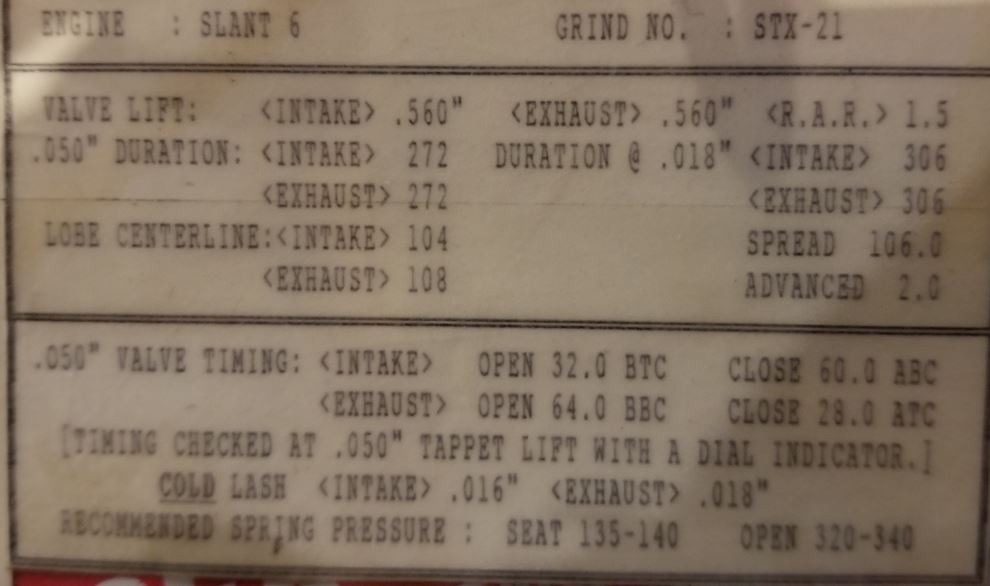

Does anyone have the specs of the STX-21 cam?
PostPosted: Fri Feb 09, 2024 8:54 am
Posts: 14850
PostPosted: Fri Feb 09, 2024 11:24 am
Posts: 10273
272° @ 0.050" is some pretty serious stuff with over 1/2" lift. Effectively Larger than my Ruster cam.
Cool Stuff.
I am guessing it's a flat tappett, not a roller Lobe/ Lifter, correct?

I've got a couple Mike cams that are over .600" net.

I am not certain that the lift is the biggest player.
It of course helps but I think the lobe profile/rate and lobe timing to the position of the piston in the cylinder have a large impact on things too.
PostPosted: Fri Feb 09, 2024 4:42 pm
Posts: 9335
Mine in the car now is 270 degree @ .050 and .570 lift. Most lift above .500 is just a "valve spring test" :D :D

Anything under .550" is a lawn mower cam

THERE IS MY ZILLA!!!!!!!!!
