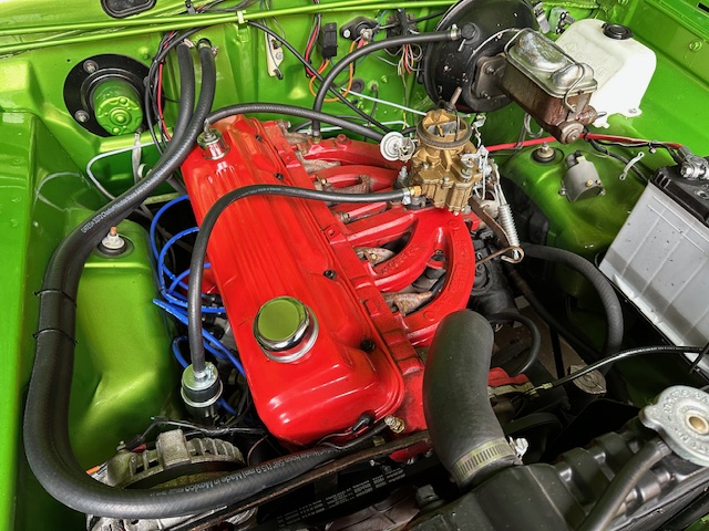

Just installed today, I think it looks clean.
PostPosted: Sun Mar 24, 2024 6:27 am
Posts: 10323
You might consider replacing long sections with metal line for safety reasons.
Rubber fuel hose on either end to connect the metal line to the carb. Or better yet bend up some appropriate 5/16" fuel line with the appropriate flares and fittings from fuel pump to the carburetor.
Best of luck!
