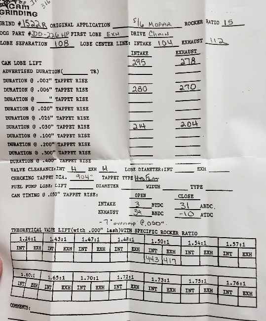

Got the cam back from OC. Here is the specs.
