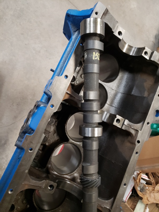

Cam is in and bolted up the oil pump. It's tight. Tough to spin the cam with the oil pump in place. Is this normal? New old stock mopar oil pump. Finally starting to put this together.
ETA Picture of cam before installing.

PostPosted: Sat Apr 20, 2024 4:42 pm
Posts: 3178
shouldnt be.
did you spin the cam by itself before you bolted up the pump? Could be "tight" cam bearing or a burr.
I mean yeah, youll feel some drag with just the cam and oil pump but it shouldn't be "tight"

Cam spun freely. With the oil pump in it just moves forward and backward. I can get the oil pump to spin but it takes effort to hold the cam in place. Went ahead and put the crank in. Had trouble getting the 3 oil rings to slip into the groves. Number 1 piston took a bit of fiddling then they popped in. 2nd piston the bottom ring and wavy ring would not fit in the groove. Guess I wasn't holding my stuff right. Will try again tomorrow. Tired and going to bed.

I loosened the oil pump bolts and the cam spins freely. Tightened bottom 2, with the oil engine upside down so the top 2, and still spins freely. Held the pump away from the cam. Started to tighten the bolts that would push the gear drive closer to the cam and it gets tight. Thinking I should swap my old gear on. Searched and found a bunch of failures but nothing saying tight on install.

The back of the cam timing gear basically keeps the cam from going too far back. That may be some of the issues of "hard turning" is that you weren't lined up exactly where it wants to go
