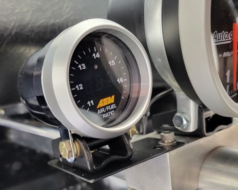

Looking at the AFR gage options, don't want to invest couple hundred bucks with something that will confuse.

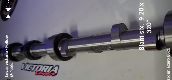

I found a lawn mower cam that looks interesting.
What do you think Slantzilla?

Looks like the next thing you could confuse yourself with. :mrgreen:
They are not confusing at all. I never remember to look at mine till I'm back in the pits. I plan to mount mine on the rear fender.

Maybe your review mirror as you drive out of their lives.
What I am reading and I know we have talked about this before, my short header extensions.
The sensor will be having a hard time reading and providing good data.
And the only one port is on the front 3 cylinders.

Posts: 10303
It will be accurate at full throttle.
Correct. I had mine in a 4 inch header ext. on one header. Only reads 3 cylinders but worked fine. I now run 12" extensions.

AFR Gauge has been installed.
It won't read AFR at Idle, experts say not enough tube length.
