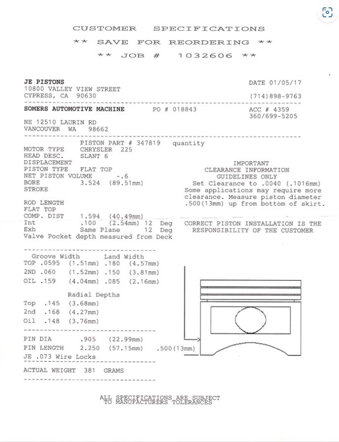

Do these pistons differ from the drawing that was posted early on?

That is just some custom piston that a board member had made from JE Pistons. Totally different piston and different company. I agree that is confusing...

I will note that those one-off pistons cost something like $750 in 2017, which is about $1000 in 2024. This gives an idea of the excellent price on this current buy of forged pistons. If Doug and I charged for our labor, it would be $700/set easy...
